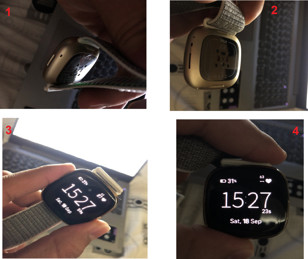

@Ali14548 I've done tests on this with fitbit sense, the real reason is when there's something close to the watch sensors. Do a test and see, if you leave it with the sensors resting on the nightstand or drawer, it will continue to set BPM, now if you leave it with the sensors up where nothing is nearby they have disabled and will no longer set BPM. Take the test and report it to us
@SunsetRunner See in the photo:
In image "1" we see the bracelet a little away, but the fitbit sensor captures it anyway and keeps marking BPM as if it were attached to the wrist. On image "3" you can see what I just reported about image "1".
In the image "2" you can see that there is nothing close to the sense, with that it turns off the sensors and doesn't mark the "Ghost BPM" anymore. See image "4" for an example of what I report in image "2".

Thanks @IgorR11 ,
Your tests confirm what I thought.
Now it's just a question of remembering to check the Sense position when we take it off and leave it somewhere and see if its back lights and HR turn off after a little while.
Good job!
Thanks Igor. I've been trying to leave the sense upright and it seems to be a lot better.
