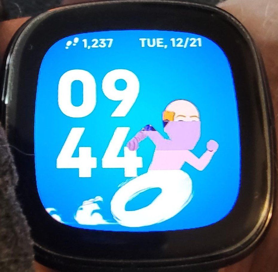

I recently upgraded to a Fitbit Sense from a Fitbit Ionic paired with a Samsung Galaxy S21 Ultra - I've added the Bitmoji clock face successfully but many of the images that pop up are incomplete - has anyone else noticed this and is there a fix for it? Thanks!
Update: Dec-23rd - this is also happening with my wife's new Fitbit Sense so clearly not an issue with just mine - has anyone else used the Bitmoji clock face with their Sense recently and seen it work?
Edit: here are some examples:

Best Answer@EdsonFitbit - yes, I did use the advice @Clove6060 posted above to reach Customer Support - they walked me through alot of steps including a few that I had not tried - their final offer was to give me the option to replace my Sense. Given this unit was brand new as was the one my wife has which is exhibiting the same behavior I just couldn't believe there was something wrong with the Sense.
I did one more thing that seems to have answered why this is happening - as I mentioned in the original post, I'm currently using Android 12 on a Samsung Galaxy S21 Ultra. I disconnected from that and reconnected using an old Apple iPhone 7+ and everything works flawlessly. I then disconnected from the Apple and tried an old Google Pixel 3XL (also running Android 12) and the problem resurfaced.
So for anyone who stumbles across this my guess is that Android 12 has a bug which is messing with Fitbit's Bitmoji clock face. Hopefully they will get that sorted someday soon for those who don't have access to an Apple device or an older version of Android.
