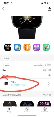

If you go to the clock gallery, there is a link to contact developer.
