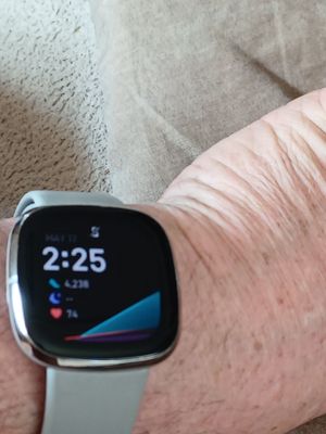

As for connected, let's look at the Sense itself, if the Sense and the phone has disconnected. When the display first turns on, you will see a phone icon with a slash through it. This icon soon fades.
When I turn the phones BT off I see this icon. After turning the BT back on, in about 5 seconds, this icon will not display, telling me the Sense is connected.
