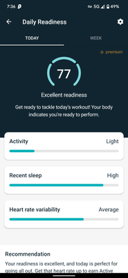

Can someone please help shed some light on the daily readiness score. It doesn't make sense at all...most days I have a good sleep score because I slept enough, but my sleep always averages at below my target.
And now today, it is showing my activity intensity is high so I'm not ready to exercise, yet my total active minutes for the last week was 1 minute 2 days ago...
It just feels to me the scores are getting all mixed up like they've confused sleep with activity 🤷🏻:female_sign:. All other functions and tiles track fine. Just readiness that completely confused me.

But shortly I agree with you. The DRS makes not much sense at all. I believe this is because of averaging data over a few days (and Fitbit loves averaging) and taking too many simplified components into the equation. I don't understand why AZM contributes to the activity level as you may get ie. 90AZM easy way and hard way and despite the same number, it may bring totally different impact on your body - single number metric is too simple and blurs the data. The same about HRV - only measurement done shortly after waking up should be used (3-5min). Averaging the whole night blurs data again. For me, DRS shows always a very high score labelled "Excellent" even when I need to recover after running races. I tested DRS, doesn't give me anything useful and I don't know how to use it (and Fitbit isn't giving any details) so I stopped checking it.

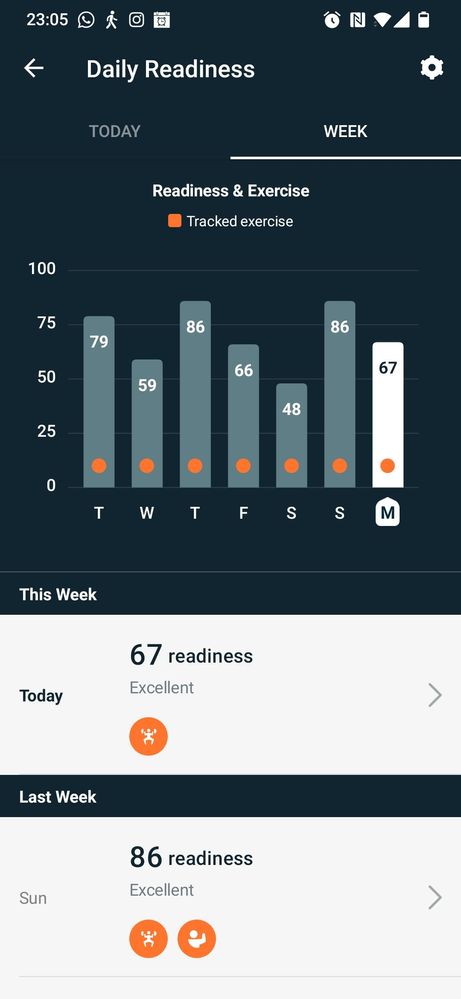

My score is always too high, like today it was 67. I had a bad night 5 hours sleep and i have been doing excersies almost every day and still my score is so high. I dont know how good this system is for crossfit and powerlfting because my muscles nervous system is done for the day.

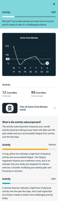

I'm curious what your readiness screen breakdown looks like. Also, tapping the information "Activity", "Sleep" and "Heart rate variability" gives it's reasoning for the score. It seems appropriate for me because after doing 3 days in a row, I went down to a 1.

Activity "light" when you have worked out everyday is definitely suspicious. Tap that and see why it thinks it's light. Maybe you're not hitting the zone levels? Apparently with wrist monitors it can be difficult to get proper heart rate readings with weight training.

@Hingane my guess is that using AZM is a problem for the algorithm as it doesn't take into account the real intensity of your exercise. There is a big difference between 60 minutes of low-intense exercise and 30 minutes of exhausting HIIT (which will give you also 60min AZM if you hit the x2 multiplier). AZM is not a way of indicating the activity level for readiness because a single number doesn't contain a crucial piece of information - how intense you went. I had a very similar output from DRS and my activity level was always marked as low because of AZM. One example is when on Nov 28 I ran 21.1km. My AZM got multiplied x2 giving me 221min. And that's fine but then, I spent lots of time over my threshold due to running uphills. AZM sees no difference between tempo, threshold, and anaerobic (+neuromuscular) effort. The last two contribute to muscles breakdown. In other words, you may get certain AZM with various ways of exercising. AZM doesn't contain any data that says the activity was a huge effort or not. This way next day you are perfectly ready after a long sleep (on 29 Nov I received excellent readiness, just my body didn't feel that). The same activity was evaluated by FirstBeat as "overreaching" and "very demanding" and indicated some anaerobic gains (muscle breakdown), Strava labeled my run relative effort in red as "Massive" (that was a race). Only Fitbit didn't notice the difference between running a half-marathon and walking to the store to buy rolls for breakfast and according to AZM marked my activity level as light. If I ran slower, staying in tempo zone, below threshold (Fitbit's cardio) I would gain AZM x2 as well but the run would be longer and I wouldn't feel that exhausted in the end. But I would get more AZM and maybe I'd get a Moderate level of activity despite not being that tired (staying below the threshold would turn my run into pleasant endurance activity)🤣. The algorithm is flawed because it's based on incorrect assumptions. That's why I stopped checking DRS because it's just a magic number based on pseudo-science.
