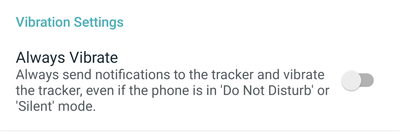

Right you would feel the 10 minute remaining in the hour reminder because that's coming from the watch. But of you have any notifications from your phone, it won't vibrate at all if you're on silent. At least for me on Android it doesn't.
There's is a setting in app notifications to always vibrate. Actually I'll turn that on as I'm typing this.
That's crazy to me you can't feel your alarm that often. I wake up to it every time. I also use the timer pretty frequently and never miss when that goes off.
