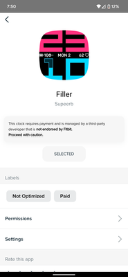

Is there a specific clock face you would suggest to get max battery life? I am fine with using any that shows a digital clock, date, and step count.
@DipenThakkarI can get 4 whole days with these settings no matter the watch face. I also don't use ones with animations:
Brightness dim, screen wake motion and button, always-on display off, snore & noise detection off, SpO2 on.
My current favorite one is is "Filler"
It looks great in always-on, each number gets "filled" towards your goal, and you can tap to show the specific numbers your at. It is $1.50 though.
