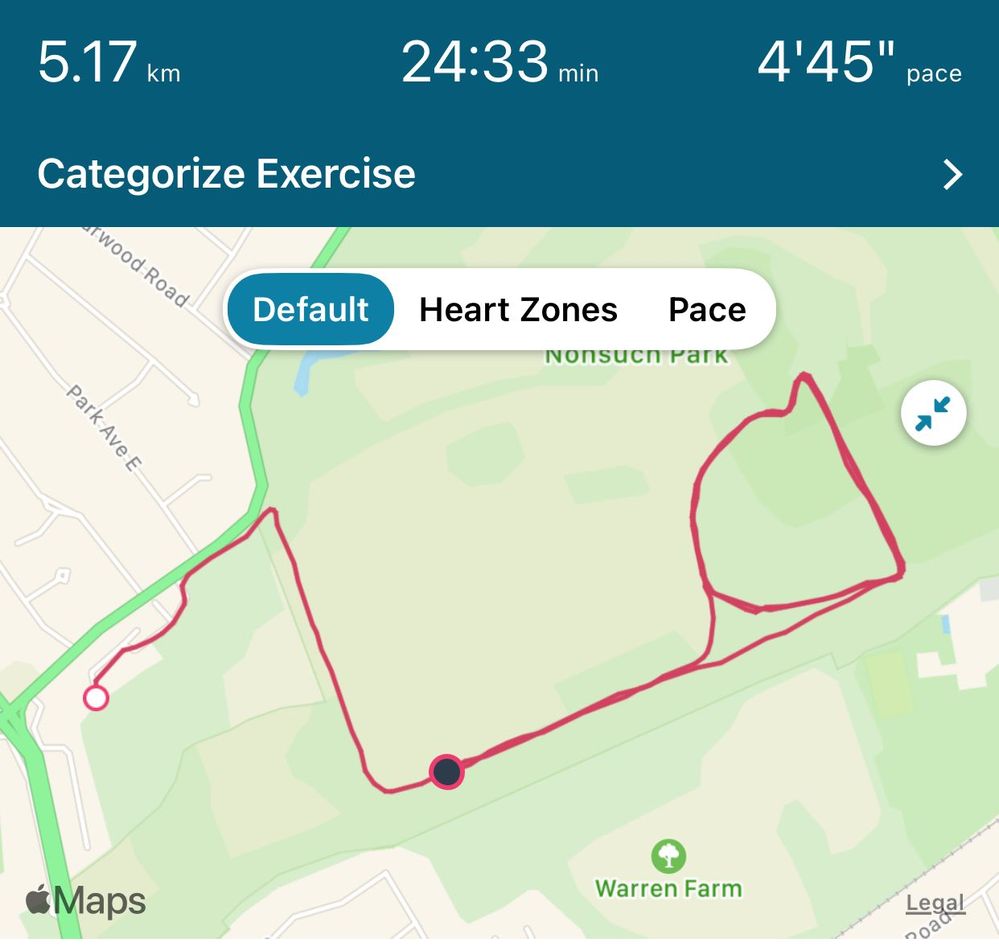

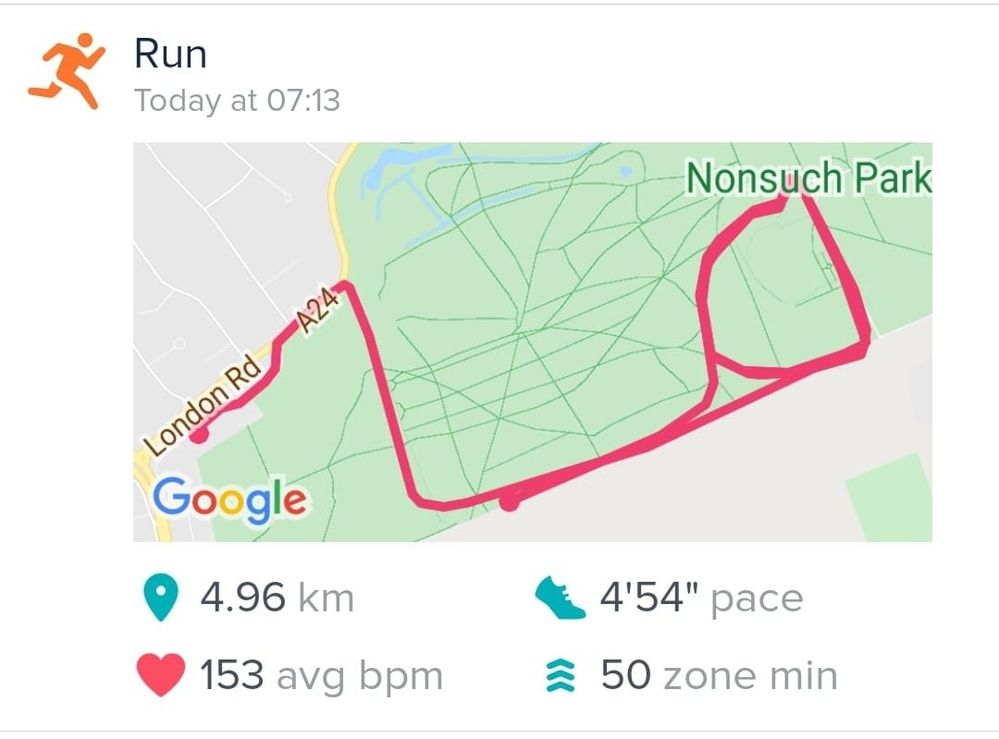

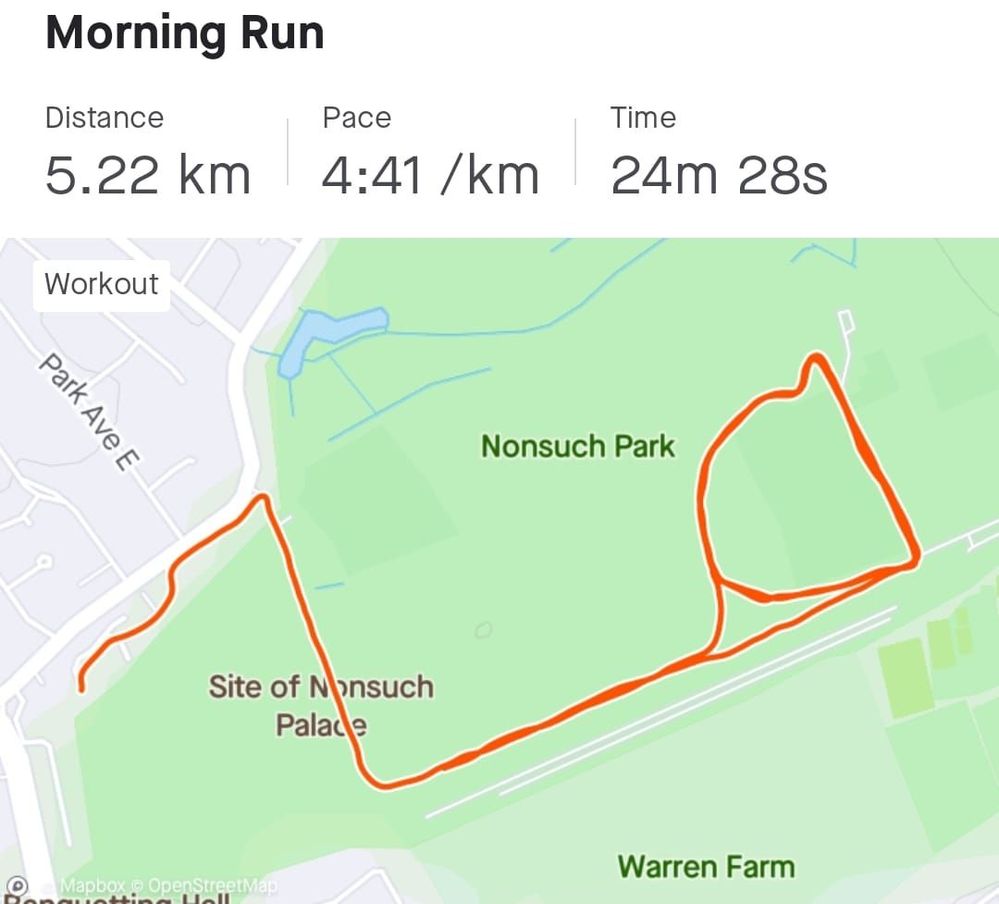

I was always a bit suspect of the built in GPS on the Sense. Firstly, routes that I had ran for months and recognised as 5km by Garmin and Strava were now coming up shorter and my splits were all slower.
So I ran a route with an Inspire 2 connected to an iPhone, the Strava app on a Samsung S20 and the Sense on my left wrist using built in GPS.
Inspire 2 - 5.17km
Strava App - 5.22km
Fitbit Sense - 4.96km

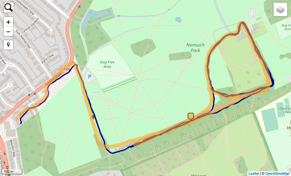

@SunsetRunner export TCX file and upload it http://mygpsfiles/app . You will be probably surprised that the distance of the GPS route and the distance reported by Fitbit is different. The reason is that the Fitbit algorithm uses steps and stride length also for the GPS-based runs. It's not bad GPS, it's Fitbit implementation of the distance calculation (it's been like that for years). Because the stride may change during the run, sometimes you will get a better result, sometimes worse, and sometimes horrible. Connected GPS won't solve the issue (my old Charge 2 suffers the same problem, then Ionic with built-in GPS, and now Sense, too). This won't get fixed as it's not broken, it's how it has been designed to work.

This image from the site posted above shows that the Sense GPS does lose track quite a bit. Blue line is the Inspire 2 connected to an iPhone and the Orange is the Sense which is very wayward and covers areas I did not even touch
