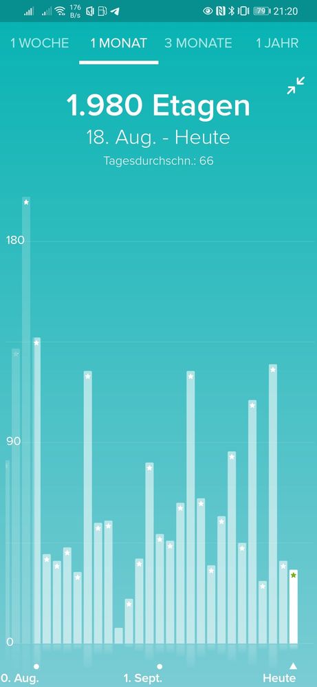

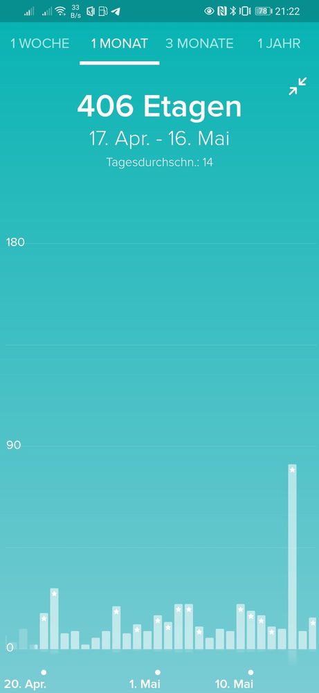

Here you can see my massive increase happening May 2021 - coming from around 14 floors per day to 66 without changing my daily routines:
