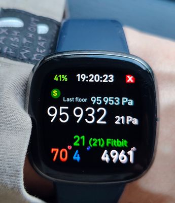

Great job! I hope you can make some sense out of the difference in floor counting in your app and in Fitbit's algorithm. I'm completely puzzled by today's results. In my office, I walk/run up 4 consecutive floors - I've done that 3 times today. I cannot understand how SimpleFloors did not count a single floor on 2 of those occasions. It seems to be registering very slight changes in barometric pressure even when sitting at the desk and not moving...

OK, I'll try going slower upstairs. I'm trying checking again today with SimpleFloors. So far, I went 4 floors upstairs, SimpleFloors registered 0, FitBit 7. But I went quite fast (chasing a waiting delivery man 😉). Will try if slowing down makes any difference.
Today's evening score...
SimpleFloors: 4
Fitbit: 21
Floors actually climbed today: 10
Walking up slower seems to increase the chance that SimpleFloors registers the floor correctly. But it's not always the case. And it's just for testing purposes, of course... none wants to adjust their pace to the detection abilities of tracking algorithms.

It would seem your pressure sensor is slightly less errant than mine. Yours reads only double.
My Sense was 80 today, to 11 real floors which is nearly 8 times.
Will look at adding sensitivity to align it to different watches behaviour.
The main point to note is that if a simple app with only rudimentary access to the data, and after the event, is able to get a reasonable reading, a modification to the firmware should be able get an even more accurate result.
The whole reason is to show how the pressure sensor works (and that it is working, because some people get no floors) and assure people their watch is not actually faulty.
