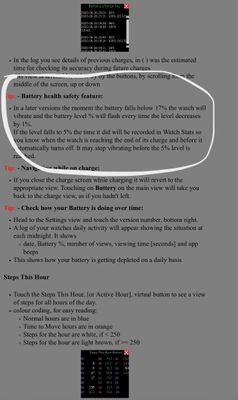

@Idontneedaname - the confirmation was that the watch face vibrates down to about 5% and does so from 17% at every 1% change.

Best AnswerFeature works for me.
Purposely let battery level drop below 17% and started monitoring vibrations and clock face activation.
Just like Guy stated, when using SimpleClockPro the watch vibrated, face illuminated, and battery % flashed (at 17% and every 1% reduction).
http://guytec.com/fitbit/SimpleClock-Tips.htm
