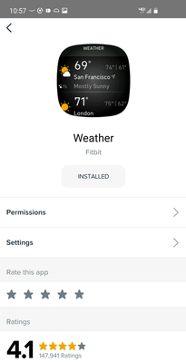

I'm a long-time Fitbit user and recently upgraded my Versa 2 to a Sense, but I'm running into a few issues completing the setup. The issue for this thread: Weather app setup.
When I try to pull up the weather app in the watch, I get the error message "No location information.  Go to the Fitbit mobile app to set up weather."  Here is what I've done to set it up so far.

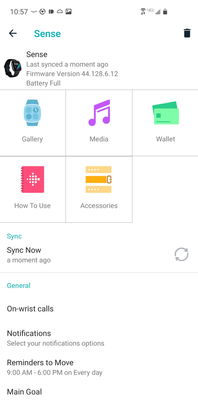

1.  I click on the "Sense" device.

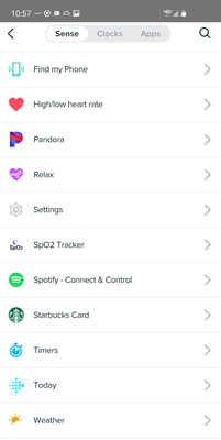

2. I click on "Gallery".
3. I scroll down and click on "Weather".

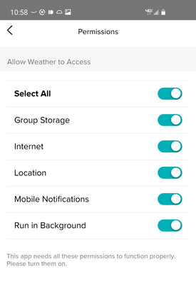

4. I click on "Permissions".
5.  I enabled everything.

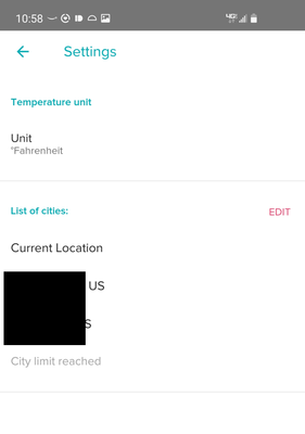

6.  I go back to "Settings" and set up some locations.

Hi @Phade  - remove the cities and use current location, then sync again to fix it.
I cleared chosen city locations and it now pulls up the weather for my current location.  Yay!!  But when I add cities, it breaks again.  Drat...  The cities were listed on the city search results drop-down and I choose then there.  What would cause known cities to break all the weather results?
@Phade  - a bug! Lol
