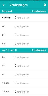

Since March 22nd I have received and connected a replacement Sense. But from that time there are no floor counts. Before the switch I always had about 6 to 11 floors (living in an apartment complex without an elevator 😅).
I have reported this to Fitbit support, but after the usual unsuccessful options like restarting, and back to factory defaults, I received an email stating it was the known issue without a possible fix in the near future 🤔

Good morning @Guy_, thank you for referring me (and creating) to this app. It's great to be able to really check out if the available sensors are working. I'm going make sure the battery of my Sense is fully charged and I will test it out today! Of course I'll let you know the outcome.
Just to clarify, my Sense isn't counting floors at all.

@RonaldM-  thanks for the photo, looks like your refurbished watch is totally faulty as it is showing a pressure of 0 which is not possible. Ask to receive a new one which works.
Hey @Guy_, after some other troubleshooting suggestions from support I received a replacement offer. So a new (refurbished) Sense is on its way. Hopefully this time with all functionalities in working order. 🫣
