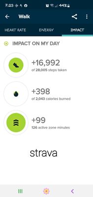

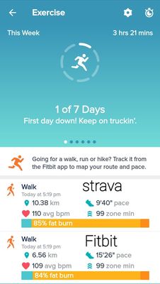

Hey Rich. These are screenshots of my walk last night. I had Strava recording in my phone. As you can see there is a huge difference between Fitbit and Strava. My daughter has a sense. Her Fitbit measured under 20 metres less than Strava. Mine is 5000 steps and nearly 4km out. I've contacted Fitbit.
