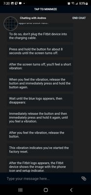

UPDATE!
I chatted with support and after advising them of my issues and the many many troubleshooting steps that were attempted in this thread, they advised me to factory reset my device. After doing the process, my fitbit sense started working again! I will say that doing the software update on the fitbit sense is better to be done on a wifi connection! I will also post the steps given to factory reset your devices as well. I hope this helps you all. Have a great day!

It worked!!! the factory reset did the trick! Thank you!!!
