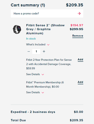

So how I love my Fitbit. Now even worse, I went to go see about purchasing a new Sense. Added it to my cart at the listed price of $229.95. I applied my coupon for 35% off and the price went down to $194.97 unreal. That would be a $34.98 discount, not 35% as the email stated.
