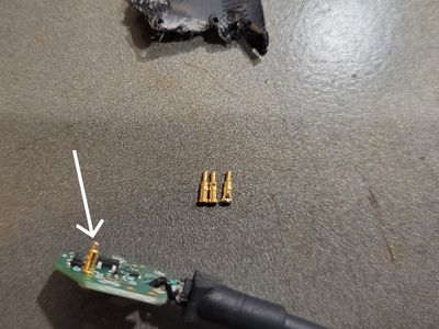

There are 4 magnets in the charger. One in each corner. I'm on my second charger with the same pin that is stuck. As somebody else mentioned, it is the internal spring of the pin is broken. I can pull end of the spring out but nothing is keeping tension on keeping it out. The pins are magnetic or the mechanism inside the pin is magnetic.

After burning through 7 chargers in 2 years, I think I finally figured out how to stop this from happening. My shortest lived charger only lasted 2 weeks and in that 2 weeks, I accidentally left it on the charger for a full 24 hours. I'm sure that entire time it was vibrating at least several dozen times an hour with the "Slow Charging" message.
This got me thinking that maybe something that happens when the Sense vibrates puts stress on the charger so I started turning off my Sense when it's charging. I've now been on the same charger for five months and that one troublesome lower left pin hasn't shown any signs of falling into the housing.
Try turning off your Sense when it's charging. I think all the slow charging vibrations are damaging the charger. I was burning through my chargers constantly until I started charging shutting down my Sense while charging.
