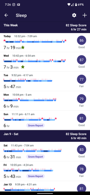

After watching for several more days, it seems the problem is related to what my sense considers to be a “day”. On Tuesday this week I went to bed more than 3.5 hours before midnight. The next morning my Fitbit reported 58 minutes of sleep on TUESDAY (but with no sleep score) and then 3:41 sleep on WEDNESDAY with a sleep score. So, it seems to be splitting a single night’s sleep into two sleep days; and since there is usually not the minimum 3 hours to calculate a sleep score it’s effectively skipping sleep before midnight most days. Alternatively I could be so extremely restless for the first few hours of my sleep it thinks I’m awake when I’m not; but I don’t think that is happening.

It's been very accurate for me with the starting time. Even the video I linked above objectively says it's a good sleep tracker in comparison to an EEG. Last night I tried to sleep around 10pm, got up to do something, it was 1010pm, and this morning it marked it at 959pm with some time awake in the beging. You might just really toss and turn that very beginning. Pretty much all devices that aren't EEG based use motion, at least to determine the start.
