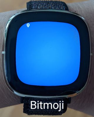

I had this Sense for over a year. It was working well until about a month ago when the numbers from my preferred Clock (SpO2 Active) just disappeared! The only clock that works now is the Original. But I want to use other clock faces! Fitbit, do you have any timeline for when this issue will be fixed on Sense?
I have already done the following:
It resulted in no change. Please see the pictures below on how it looks on my Sense.

Thanks FloppyDrive (I like the old-school codename), I went through all the suggested steps and I even went further by uninstalling the app on my phone. No change, unfortunately.
What? Memory fail? Argh! I hope not.
I realized I didn't try the factory reset as the last resort.
Update: I performed a painful factory reset and it worked! Thank you for inspiration!

Something I would suggest trying is to change to a non-SpO2 clock face, then go to the apps and uninstall the SpO2 Tracker app. Then shutdown your watch in the watch settings. After you restart it, reinstall the SpO2 tracker app and try an SpO2 clock face.
It could also be that the memory in your Sense has failed.

Thanks Patruns, I actually want to have continuously available the Active Zone Minutes at a glance which was what the SpO2 Active clock face offered me. Thanks for the note on the battery life, I actually didn't realize it. I really enjoyed the convenience after about 10 months of using that. What puzzles me the most is, why it stopped working.
