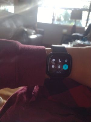

Best AnswerSleep mode is not activated. But when I ask Alexa a question I get the written answer and an x by the speaker symbol! See below.

You have to make sure that the sleep mode AND the do not disturb icons are not lit up. I had the same problem, and my do not disturb icon was lit up. Check that the moon and the - icons are not highlighted
I have this issue and nothing is highlighted. Also tried touching the mute icon and adjusting that way, but no. Still muted.
HJNelson, Thanks!!! That got rid of the mute on my Voice Assistant!!! Yay!!!!
