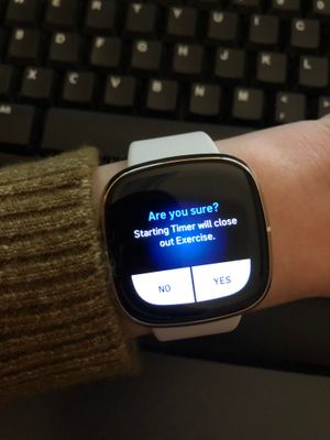

@mlgsilva Hello! The timer is a separate app and across all Fitbit devices, you’re not able to switch between apps. I even tried setting the Timer as the long press shortcut for the left button and I got a warning that said opening Timer would end my workout (see screenshot).
However, you can control music with the workout screen performing in the background. Just not other apps.
