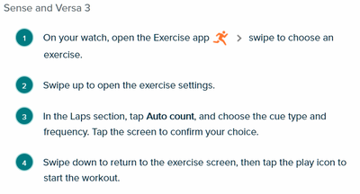

I have recently moved from the Ionic to the Sense.
I walk 3-4 km. on most days. On the Ionic - with the GPS 'on' - I used to hear a buzz and get a visual sign on the clock face whenever I completed a km. That does not happen on the Sense.
How do I make it happen?

Before tapping start @FitbitUser1112
You will see an up arrow at the bottom of the screen.
Swipe up and setup the features that you want.
This is explained in your user manual, available through the below help link.
2 REPLIES 2

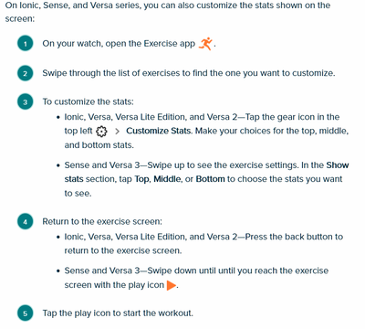

From How do I track my workouts with my Fitbit device?
Also
You can also find this info in the Sense Manual (pdf) .
