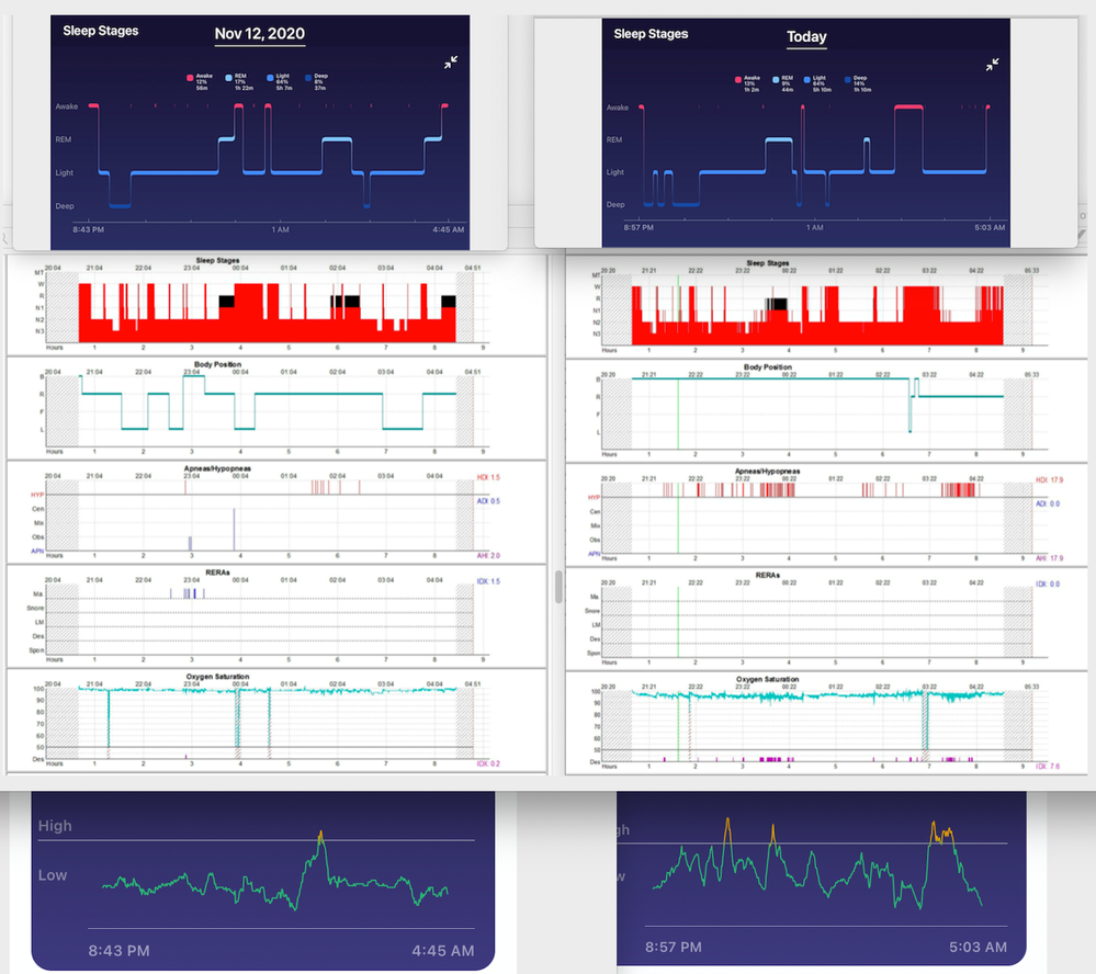

I have had two recent sleep studies, one in November and one 2 weeks ago. Both nights I had my Fitbit on. The SpO2 desaturations that I had in the sleep study were seen by the Fitbit. Interestingly, the first study had one minor de-sat (to 92%), while the 2nd study had 3 serious de-sats down to 86%-88%. The desats in the second study didn't look more "serious" than the minor de-sat did -- they all 4 bumped the same distance over the line into "high".
So, yeah, the chart is kind of vague compared to what the PSG shows.

This is impossible to align exactly because fitbit refuses to put a proper x-axis on these graphs, and my psg doesn't display data very intelligently either, but you can get the idea.

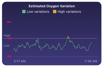

Why would the FDA be hesitant to allow a graph of O2 saturation versus time when they have no issue with the Pulse Rate versus time? If the FDA doesn't allow O2 data to be recorded and graphed, why would the FDA permit the 02 data to be displayed on the clock face? Puzzle.
@GoodGuy5000HD wrote:I can understand why the FDA was hesitant to approve the Estimated oxygen variation (EOV) graph: with little guidance about what constitutes a "problem,"
For sometime now I've been trying to get someone at Fitbit to explain what the Y-axis (on the left hand side) of the EOV graph represents. The latest explanation is that the Y-axis is actually 02 readings with the bottom of the scale at 92% O2 and the top of the scale at 98% 02 and the dividing line between "high" and "low" at 95%.
(In red, I've inserted the suggestion made by the Fitbit rep).
But that explanation doesn't make sense when combined with the statement directly below that says:
I had originally expected that the Y-axis label to be CHANGE in O2 with a scale of (say) 0 to 10%, that would make some degree of sense. But then what do you do with negative changes (for example the observed 02 changes from 95% to 92%..... that would be a -3% change).
I wish that I could get someone at Fitbit (or in the community @ this forum) to clarify what the scale on this graphic is supposed to represent. This question has been asked over and over again over the past 3 years without an adequate response.
Even my doctor can't interpret this graph, so does it provide some value.

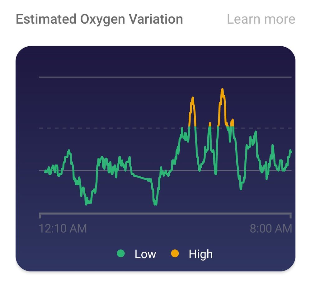

Attached is screen shot of my oxygen variation from FitBit Charge 5. What is it - per FitBit's suggestion - that I tell my cardiologist this is? Am I well? Do I have a problem? I'd rather know nothing than wonder what this may be indicative of.
Please advise.

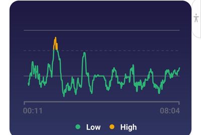

I have mild sleep apnea. This is mine without a cpap.
Having 1 or 2 spikes that don't stay in the high for long, wouldn't be super concerning. Everyone has some sleep episodes. It's when there are many episodes, every night. If your worried ask your partner if they notice that you struggle to breathe during sleep or make gaging noises.

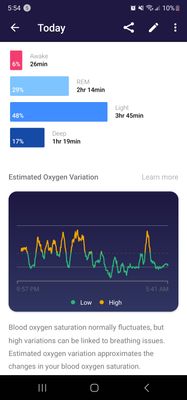

I was having a lot of extra heart beats and getting Palpitations in my chest and turns out I have PVC pre ventricular contractions. After testing it was revealed I have a slightly enlarged heart and doctor sent me to sleep clinic where I was told I have sleep apnea and need CPAP even though I don't snore. Of course he never showed or sent me the data. I'm just supposed to accept whatever the deity says but my graph from fitbit does seem to confirm there's a lot of variation in blood oxygen. Anyon3 else care to paste their pics to compare. Mine has lots of spikes.
