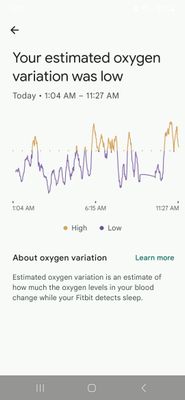

Since my EOV graph has been activated, most days show a squiggly line in the low range. However, over the past 3 weeks, I seem to get a single spike past the "high" threshold once every 2-3 nights. Is this enough of a "problem" to schedule a sleep study?

If anyone is interested, this is what my oxygen variation looked like BEFORE
l was diagnosed with severe complex sleep disordered breathing. When these were recorded l was having 50 events per hour, ie a lot of central apnea and hypoxia , as well as obstructive apnea, and l had cheyne-stokes breathing 80% of the night.  These are the worst looking ones, but l also had plenty that were well down in the green.  I have been having cpap therapy for a couple of.months now but my fitbit sleep stages graphs don't  look much different, even though my apnea events have gone from 50 per hour to around 5 per hour. The number of wakes are the same, l just get a bit more deep sleep time, which is good.   The oxygen variation  still gets occasional peaks over the line, but does look better .  In general, l don't  think that fitbit provides much useful information that could point to a suspicion of sleep apnea.  I can't  see that anything screams severe sleep apnea on my fitbit history.
It is outrageous that this so called graph has no bearing on actual oxygen levels. WHAT O2 LEVELS ARE THE DOTTED LINES FOR PETES SAKE. The implication to the layman is that a high spike is bad and a low spike is bad but actually a high spike MAY BE an oxygen level well OVER 95 and not a problem. My sleep doctor also had no clue what the graph meant. But what it DOES MEAN is that folks like me are scared into EXPENSIVE SLEEP STUDIES that are totally unnecessary.  Crap data is crap. Period.

 this is how I'm looking every night. I wake up gasping. Sometimes I feel like I'm about to die. I have nightmares I'm suffocating almost nightly.

@Annatopia sorry to hear of your struggles to get help. I’m struggling to understand why it still says your oxygen variation is low at the top, despite all those spikes into the high variation zone. How many must people need before it defines it as high, I wonder? Doesn’t seem right!
