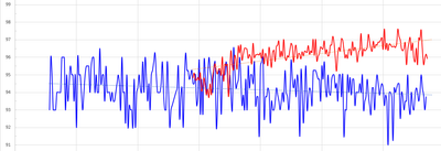

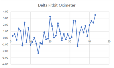

Never solved. Delta continues to be about 2% from daytime vs.sleep. That said, it is within the measuring error of the devices of +/- 2%. See the latest Oximeter vs. Fitbit plot below. this is just short of 9 months of data.

I fully agree. We can opine till we are blue in the face, but it would be great to hear from the Fitbit people. I will update the graph every so often as well.
