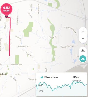

Or, for that matter, why two identical runs can have vastly different elevation graphs, starting at different elevations, with different elevation gains (both of which should be 0, since out and back should cancel out)?

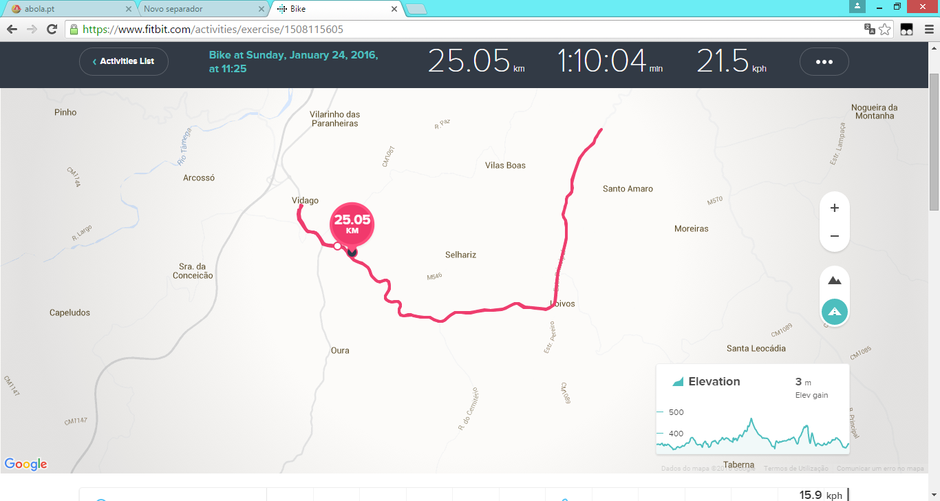

As you can see in the pic the elevation gain was 3 m on 25KM bike run:
