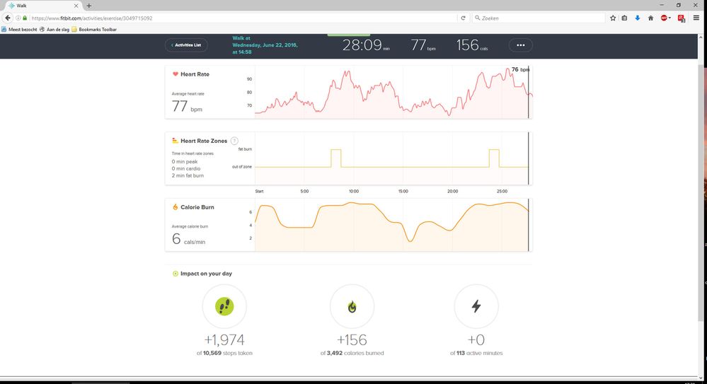

Let's compare this to a slow walk:
So 28 minutes of slow walking, with an average pulse of 77bpm and I burn 156 calories.
Let's compare both, 1 hour cycling, a higher average bpm but a 3 times lower calorie burn? How the beep is this possible Fitbit?
One can easily see the cause of the miscalculation by comparing the graphs. Somehow Fitbit assumes that during my ride all activity below 95 bpm and/or 20km/h is the same as sitting, as it calculates a burning rate of 1,6 kcal per minute. Only for a moment the burn rate goes up to 4 kcal per minute, as my pulse gets to 98 bpm.
During the walk, the Surge uses a burning rate between 4 and 6 kcal per minute.

For once, the problem here is not really with the heart rate readings, I have a pulse around 80-90 during that exercise so that's correct.
The problem is the calorie count for cycling (and perhaps) swimming with such low heart rate. The Surge assumes that while cycling slow I am burning the same amounts of calories as sitting, which is not true.
The Surge makes a jump from 1,6 kcal per minute to 4 kcal per minute, between cycling slow and cycling normal. That's an insane difference, almost 300%.
You would agree that you or me don't suddenly start burning 300% more calories while going just a bit faster?
