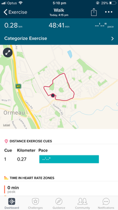

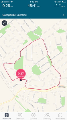

i have done as you requested and the step count is correct when doing the 100 step test.
the problem is when i have the "walk" function on, it records distance, speed and steps incorrectly.
I have gone on a walk today with the "walk" function on.
It is using GPS (i make sure it is connected before i leave) and has mapped the track correctly - but as you can see in the photos i have attached, I have synced the Fitbit to my phone and the distance says 0.27km. I know for a fact that it is approximately 3km.
It has recorded 525 steps - I would have to have a stride length of over 5 metres for this to make sense.
And it did not record the pace at which I am walking at all.
I wear my device on my wrist as I always have. I have not had this issue in the past - it has only started to happen in the last few weeks.
Thank you
Iesha

Thanks for getting back @Ieshabunny. Thanks for all the details on your post and for the pictures attached. Sorry for the time it took me to responde, I hope you're doing great.
This is not a normal behavior from the Surge. Every walk might be slightly different in regards to steps and distance since we not always walk exactly in the same way and on the same path. But these are too many steps and kilometers.
You mentioned that you've performed the restart on your Surge, that should be helping your Surge internally too. Let's forget your Surge from the Fitbit App > Dashboard > Surge > Remove. Then remove it from your phone's Bluetooth and pair it as a new device. Try again the restart before connecting it with your phone. Then please try the same path so we can test your Surge.
At least 24 GPS satellites are constantly in orbit around the Earth and broadcasting data. All GPS devices, whether your phone or a Fitbit device, require a direct path to these satellites in order to receive their radio transmissions. If the signal is blocked either because you're underground, near many tall buildings, or as a result of atmospheric effects GPS won't work. While GPS gives you a more accurate measure of distance than step counting alone, in this case we need to confirm if this feature is still working or if these discrepancies are been caused by the environment and the weather.
Would you be so kind to do a walk with your phone's GPS to test the accuracy of both options? Please follow the steps here to use the option Mobile Run.
