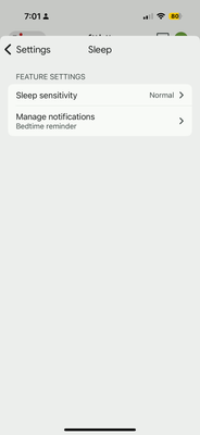

I'm not able to set my sleep schedule. I guess the update took it off bc it's not there, it says 'no sleep schedule set' and i can't find the place to add it. I clicked the right corner dots and selected sleep settings and nothing is there to add or change the bedtime and wake-up times. Maybe that's affecting my sleep score? I would appreciate your attention to this. Thanks
It seems as if these updates are incomplete. There is absolutely NO place to add your sleep goal.

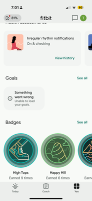

Had exactly the same problem after the most recent update. I uninstalled and reinstalled the app and that fixed the issue.

@Lakeelake Do you use an Android or iPhone? What app version do you have? Can you include a screenshot that show it missing? Can you see this option if you tap on the You icon, then Sleep goals there?

You didn’t ask me, but in case it helps, iPhone App version Fitbit 4.42 (44231015)

@Ceela Your issue is a little bigger than the sleep settings. Some, but not all iOS users can't set any goals. Fitbit is aware of this issue.
There is a longer thread in the iOS app forum. Try deleting, then reinstalling your Fitbit app. Some users said it worked.
