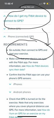

see instructions above they’re not very helpful. ‘How to connect to gps’ - go outside and connect to gps 🤦:female_sign:
all my phone settings were correct, I was connected via Bluetooth. I have managed to figure out self that I need to track instead of log? But surely they should be the same thing.

Hi Talathas,
thanks for your response. I have read all this already and unfortunately it does not help. It says the gps should come on when you select a run on the versa 4 which does not happen/ I have everything right in my settings. I think perhaps I need to press ‘track’ run instead of ‘log’ run in the app but totally defeats the purpose of having the watch at all when I already have Strava. See picture for reference.
Best Answer07-12-2023 10:24
07-12-2023 10:24
You're welcome, @CiaraMags.
If I remember right, I had to go to the exercise's settings the first time to enable GPS for that specific exercise. This GPS setting is then stored for that exercise.
GPS won't be activated if you are using auto tracking, btw. You have to start your exercises manually to get GPS tracking.
