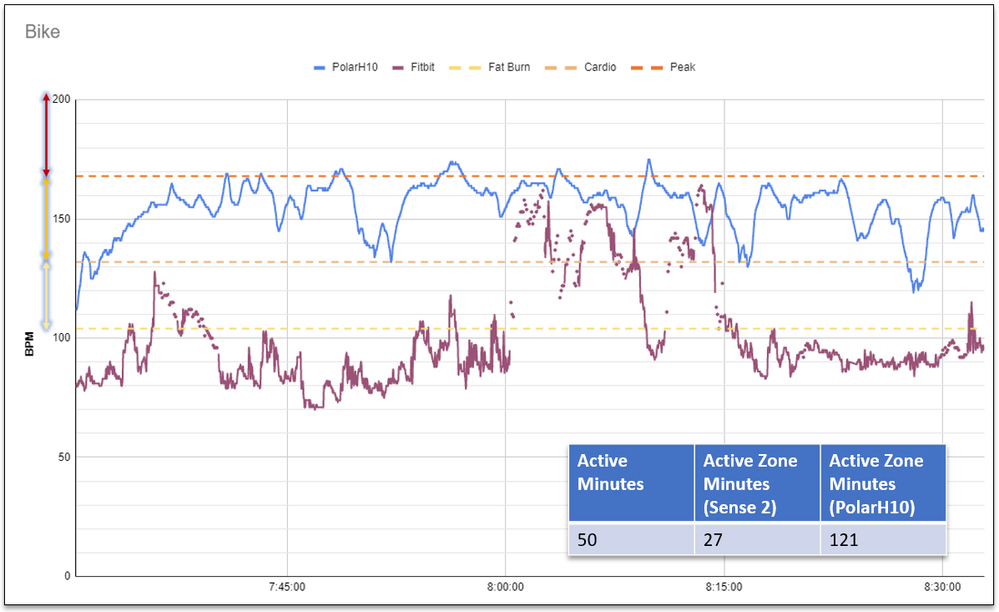

@Mark_1982 you seem to be mixing up active minutes (Surge) and active zone minutes (modern Fitbits). You have been granted AM sometimes regardless of the HR zone. I know it should be granted for more intense activity but my experience with Charge 2 tells me that just by starting tracking exercise manually, the AM were piling up. I think the intensity factor was used only outside of regular exercises. In other words, getting AM was dead easy. When Fitbit introduced AZM, it was harder to earn minutes because your HR must be elevated to reach any zone. It depends on how accurate HR tracking is and whether your zones are set correctly. See how readings may differ on the following example (my 1hr bike ride):
This has been recorded with Sense 2. The purple line is HR from Fitbit Sense 2. It's not only inaccurate but it misses plenty of data points. I don't know how Fitbit treats those. I think it may just be interpolating HR between known data points. The blue line is PolarH10, the gold standard of HR accuracy.
Dashed lines represent borders between my HR zones, yellow range - Fat Burn (AZMx1), orange - Cardio (AZMx2), and red - Peak (AZMx2). Now, see the table. If it was tracked with an old device, I would earn 50 Active Minutes, just for the sake of tracking the activity. However, Sense 2 gave me only 27 because HR is ridiculously inaccurate (and it's no different on Versa 4, it's the same sensor and the same technology). If I count AZM using PolarH10 data, I should receive 121 AZM. This is a huge difference.
So double check:
- Whether your HR looks correct (and my bet is that it is a probable source of the problem)
- Whether your zones are correct (this is harder to check)
- Count AZM not AM. There are no more Active Minutes on modern devices.
