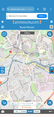

Having problems with my GPS when running.
The other day in the middle of my run there was a straight line cutting through houses where GPS has been lost.
Then today I did a 5k (see map) run but Fitbit thought it was 7k (screenshot) and didn't pick up till around 2k in
Any solutions or do I go back to logging with Strava on my phone?

Hi @Mkersyshull.
I'm sorry to say, but from my own experience GPS isn't very good on the Versa 4/Sense 2. The issue seems to be with the placement of the antenna, which is located at the back of the device. This obviously isn't good for something that requires a clear line of sight.
The FW update that Fitbit is currently rolling out is supposed to include the option of connected GPS, which might be useful if you carry your phone. Although it appears the roll out has been paused for some reason.
