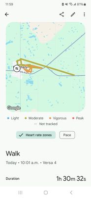

My GPS is all wonky when I walk the nature trails where I live.   I have a Versa 4 and my phone is an S23Fe.  It worked before but now all of a sudden it doesn't.   I'm just wondering why and what I could do to fix this...thanks!!!

It records but definitely not the same path as I walk.   The trail is definitely through wooded areas it's in a valley as well but it used to work just fine all the time now it's a very weird line not even really close to where I'm actually walking lol.  I have attached a picture of what it does.

  • When you say that the line is not even close. Are you referring to the straight or squiggly?
  • Since you walked 1 hour 20 minutes, I assume that the gps stopped recording.
  • Is the Versa 4 using the built in gps or the phone gps? Have you tried both ways?

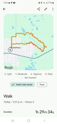

This is what it should look like and I'm not sure which GPS it uses I have my phone on me when I walk as well as the GPS on my Fitbit turned on.  The walk is about an hour and 20 minutes to an hour and 30 minutes so I don't think it turned off.
