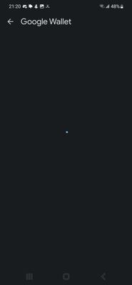

Hello, I am trying to setup Google Wallet on my Veraa 4. I clicked the Fitbit Wallet on my watch and it opened the Wallet app and I was able to setup a card. However, the watch still display Fitbit Wallet and Google Wallet is not present on the watch. In the Fitbit app, when I click the Wallet tile, it opens a black screen for about 1 second and close.
 Any one know what I should do?

Hi there, @Triwis. Welcome to the Fitbit Community Forums. Thanks for the details provided in your post about the issue with your Versa 4 and for the image attached.

However, the problem is not solve because I can't go back in the Wallet tile to setup a second card. Whenever I open the Wallet tile, I does the same as usualy, opening a black screen for 1 second and then closing again. This is very annoying. I am still waiting for support, if they ever get in touch.

I'm having the same problem. I set wallet up. And, it's working. But, I can't open the wallet app from the Fitbit app. It just opens up wallet for 1 or 2 seconds, then returns me to the fitbit app.
