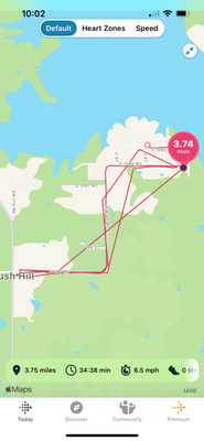

This is my 6.6 mile bike ride this morning…yesterday they were reporting a huge coronal mass ejection. 
@jon.kimmel this just shows losing GPS and taking ages to reconnect. I've been observing this behaviour many times regardless solar activity. My today two runs came up just fine on Fitbit and other devices I use simultaneously. Same yesterday night run. There was one solar activity affecting devices globally last year and that affected my Fitbit, phone, Garmin, bike computer (Edge). It wasn't only disconnecting but horrible drifting which resulted with bogus PBs in Strava (had to do lots of cleaning in Strava editing maps manually). Problems with GPS were then reported by all the communities of various brands. This is an impact of solar activity. What you are observing is regular Fitbit GPS quality.
