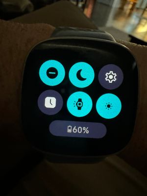

Versa 4 settings are all greyed out
I noticed my Versa would not wake with my wrist movement.  I went to settings and all of them are greyed out.  Read another post and it said to turn off all the icons (swipe down to quick setting) but they all say “Locked in Sleep Mode” and when I tap the moon :crescent_moon: it says Locked in Do Not Disturb mode.  I just did the latest update and it didn’t help. I restarted and that didn’t help.

To clarify, both Do Not Disturb and Sleep Mode are lit up and I can’t turn them off.
See my picture I posted.  Sleep mode and do not disturb are both on and I can’t turn either off?
@kbbg19 Thanks for the image attached and the details provided.

Nothing has work.  I have tried all the suggestions, except for Reset, which looks like it will be the only thing I can do at this time. This watch is not very old and it is a shame that I am already having problems😞
When I hold the side button for 10 seconds, the logo starts blinking and then a big Red X shows up and then it starts?
@kbbg19 - are you then able to get to Quick Settings and turn off all the icons?
