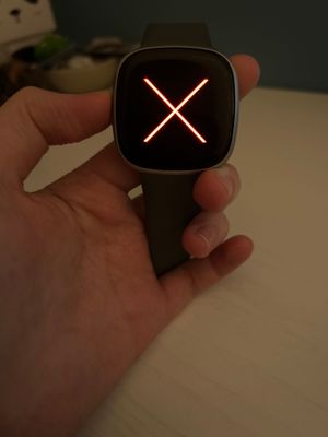

It keeps giving me a red cross
Hi there, @Beth1223. Welcome to the Fitbit Community Forums. Thanks for the details provided in your post and for the image attached. I'm sorry to hear that your Versa 4 is stuck on a red X. I understand your concern, I will do my best to help you with this!
Even when the screen seems to be dead, would you mind trying to sync? To do so, please try to manually sync your Versa 4 by tapping your profile picture > your device image > Sync Now. By doing this, a firmware update banner should appear.
If Sync Now doesn’t show an update banner, please tap your profile picture > your device image > Gallery. The app should show a popup to install the missing apps to install the missing apps and recover the device. If the firmware update banner does not show, press and hold the side button for 10 seconds until the Fitbit logo appears on the screen, then release the button. For more information please visit How do I restart my Fitbit device?
If none of the above works, please try once again a manual factory reset: Press and hold the button for about 8 seconds until the screen turns off and vibrates. When you feel the vibration, release the button, then immediately press and hold the button again. Wait for the Fitbit logo to appear, then as soon as the logo disappears, release the button, then press and hold the button again. When you feel the vibration, release the button, then wait for the watch to complete the factory reset.
I am having the same problem with the red cross have tried all that you suggested and still nothing only had the watch two months
Best AnswerHi thank you for your help but I tried and it kept coming up with error messages when trying to sync and install missing apps. The factory reset did not work.
