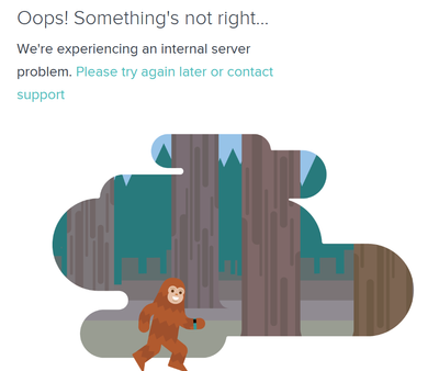

Hi Maria,
I'm experiencing exact the same thing: black screen, even after it having charged a few times during hours, just the Fitbit logo appears (sometimes), but nothing else. I'm trying to follow your advice, but when I click on my profile pic, I get the following message:
Any suggestion what else I can do?
