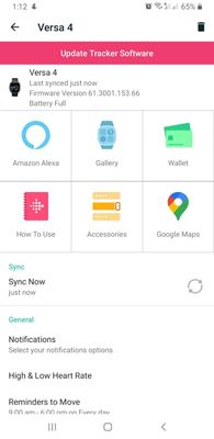

Hi there,
I received my versa 4 watch on 22nd Nov, 2023 and tried to update the tracker software but it keeps on failing and the fitbit app is stuck on installing status and then it ultimately fails. When the update starts, the status bar on the fitbit app just jumps to 78%. On versa4 it displays updating device for a moment and then device vibrates before displaying the error "Trying to connect..." (as depicted in attached photo)
