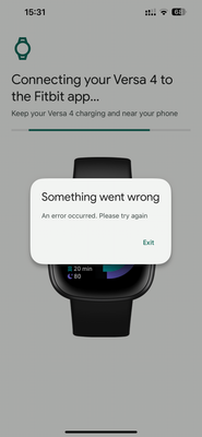

After the reset, I logged in to the Fitbit app on my iPhone 13 Pro Max iOS 18.6 and tried to add my Versa 4 again.
As soon as I entered the 4-digit pairing code, the app showed:
“Something went wrong. An error occurred. Please try again.”
I tried again. And again. I spent half a day on this.
I even thought it might be an iOS issue, so I installed Android on a Raspberry Pi, installed Google services — just to test it.
Same issue.

Thank you for taking the time to respond and for outlining the steps clearly. Unfortunately, I’ve already attempted all of them — not once, but multiple times — and I’d like to offer some clarifications based on your list:
  1. My device does not appear in either Bluetooth settings or the Fitbit app, or if it does, it disappears shortly after. So unpairing isn’t possible — the system simply doesn’t recognize it.
  2. No other Bluetooth devices are connected, except my Apple Watch, which uses WiFi within my home network and doesn’t rely on Bluetooth in this state. I hope you’ll agree that it’s unlikely to cause interference.
  3. I’ve force-quit the Fitbit app numerous times.
  4. I’ve even reset my iPhone’s network settings, restarted the device, toggled Airplane mode, and tried a clean start.
  5. I described many of these attempts in my initial post, but I’m restating them here for clarity.
  6. Yes — I’ve followed that step as well.
  7. The Versa 4 remains on the charger at all times. Without this, the battery would have drained long ago due to the endless pairing loop.
  8. I’ve attempted the setup process repeatedly, carefully following the on-screen instructions — with no success.
  9. I’ve also performed a hard reset using the physical button combination during power-up.
  10. Sadly, the final step you suggested are not available for me. The watch is stuck at the setup screen, and I’m unable to proceed any further.
If needed, I can provide a screen recording via Google Drive showing the exact issue. It clearly demonstrates the device is stuck in an unrecoverable state.

I finally fixed it. You just need to change the timezone in your App Settings to the country where Fitbit is officially selling. What a shame Google....
Wow - really ? What country is that ? My problem startet actually when I went To Greenland and the time wouldn’t synkronize. Does that mean that you can note have the actual time on your watch? Then it is unusable when in a different timezone ?
I am from Ukraine, and we do not have an official Google store here. And I think they stopped supporting Fitbit in Ukraine completely. But we have options like Finland, Turkey, Israel, or Greece to set their timezone because we live in the same timezone. So I changed to Finland and all problems are gone.
