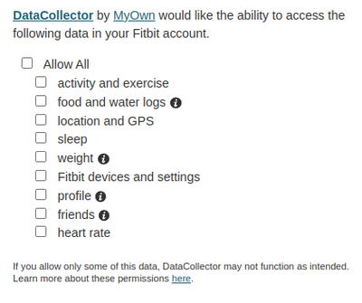

Just to confirm, when you consented to share all of your data with your application, did you see breathing rate and HRV listed in the available scopes page?

Hi @Gordon-C
No, there were no br and hrv in the listed scope page.
I have revoked access and here what it has suggested to share
So.. if these options should be here, then it's a bit strange that they hadn't been listed.

Hi, I have same issue when fetch the breathing rate and SpO2. and I could not find the scope for spo2 and breathing rate in the list. Do you know what scope is for spo2 and breathing rate?

You will need to add the breathing rate and SpO2 scopes to your authorization string. This is not required for HRV because the data set access is part of the heart rate scope. The documentation for the endpoints lists the scope you need to add at the top of the page. See
Breathing Rate: https://dev.fitbit.com/build/reference/web-api/breathing-rate/get-br-summary-by-date/
SpO2: https://dev.fitbit.com/build/reference/web-api/spo2/get-spo2-summary-by-date/
Once you add the scopes and send the user through the authorization flow again, you should see the 2 new scopes appear. The user will need to consent to the new scopes before you can access the data.
