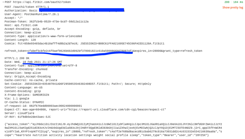

According to the OAuth2 documentation " A refresh token does not expire until it is used. A refresh token can only be used once, as a new refresh token is returned with the new access token." (https://dev.fitbit.com/build/reference/web-api/oauth2/#refreshing-tokens)
However I recently noticed that I can re-use a refresh-token multiple times and issue a new access token successfully. Based on my experiment the refresh-token is valid as long as I don't use the one that is returned in the API response.
What I've been doing so far is what I think it's the natural OAuth2 flow: whenever I issue a new token I save both the access_token and the new refresh token in my DB, but based on this finding it seems like I can just keep using the same refresh-token "forever" ???

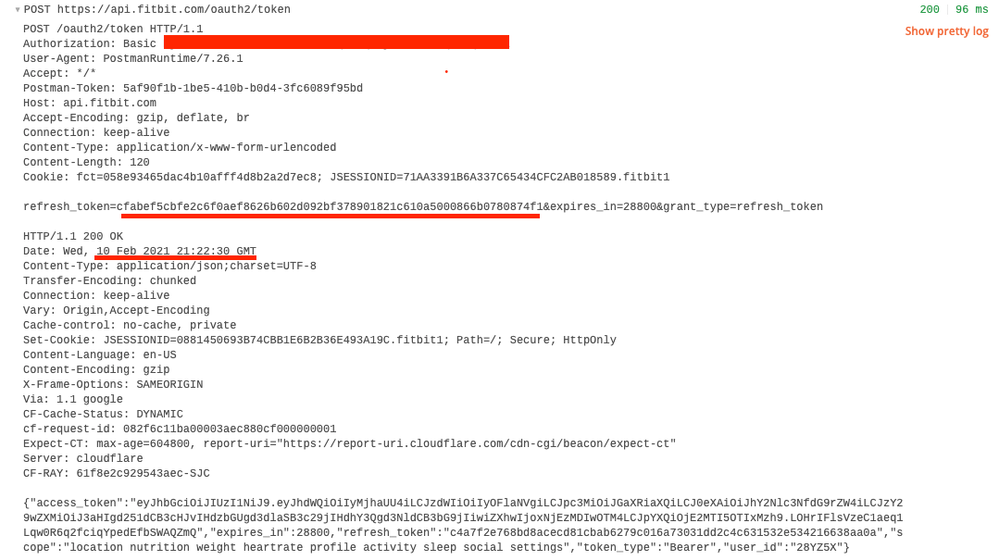

I'm attaching 2 images demonstrating that using the same refresh-token with a difference of 5 minutes I'm able to obtain a new access_token

Hi @alexperto,
A refresh token doesn't expire until the new access token obtained from it was executed in an API call. When the new access token has been used, the refresh token that was used to obtain it automatically expires. For example:
In the screenshot you provided, you executed a refresh token (we'll call 1) twice, one at 21:17:26 and the second call at 21:22:30. Since you didn't use access token 2 after your refresh attempt, refresh token 1 is still valid, which is why you were still able to execute it again at 21:22:30. Also, notice that in your second refresh attempt, you received Access Token 3 instead of Access Token 2. This occurs because Access Token 2 was not used within two minutes from it being provided. After two minutes, a new access token will be returned if the request was attempted again (Documentation).
