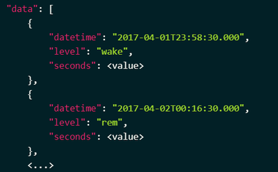

2) You said V1.2 supports sleeping stages but in grouping only. Is there anyway for me to get the clustered-style data that was shown on the Sleep Logs API page:
Thank you for your help!

The values you see for minuteData (1, 2, 3) represent: 1 ("asleep"), 2 ("restless"), or 3 ("awake").
In order to use the latest version of the sleep endpoints, you'll need to change the "1" in the URL to "1.2", like so:
GET https://api.fitbit.com/1.2/user/[user-id]/sleep/date/[date].json
The response for this endpoint should look like this:

"data": [
"datetime": "2017-04-01T23:58:30.000",
"level": "wake",
"seconds": <value>
"datetime": "2017-04-02T00:16:30.000",
"level": "rem",
"seconds": <value>
"shortData": [
"datetime": "2017-04-02T05:58:30.000",
"level": "wake",
"seconds": <value>
