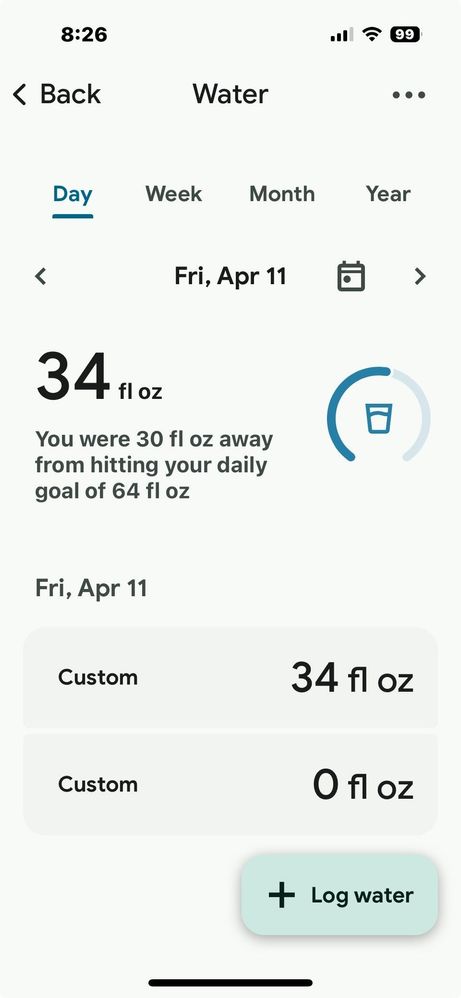

Here is a screenshot from the user above with the 29773.5 value on Apr 11.
This *is not mL* ... if it were you could multiply by .0338214 you will get 34 oz. If you do this math 2 times - 29773.5*.0338214*.0338214 you will get the 34oz. In the past versions (like the 2nd example above) the value would have been about 1006.98 not 29773.5 because 1006.98 mL * .0338214 = 34 Oz
