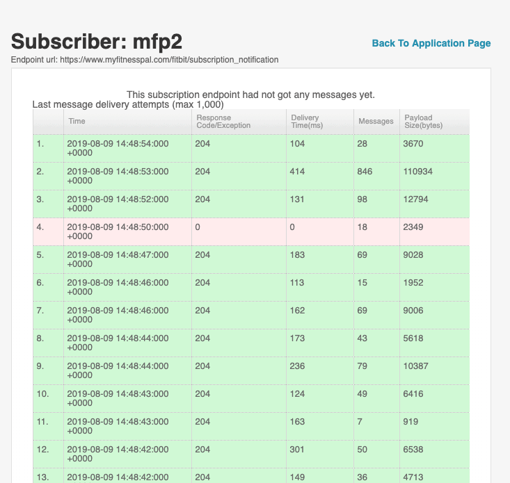

Hi there,
The last 2 days we've had several instances where our webhook notifications were turned off. Usually this is because we have some kind of web outage that causes the errors to spike over 10%, but in the last couple days, we've not had any failures and were turned off.
Has something changed recently that caused this? See the timestamp difference from line 67 -> 68 in the attached image:
https://www.dropbox.com/s/5in5r8gx5msno2d/data.png?dl=0
https://www.dropbox.com/s/sj6vhbapbj2bx80/stats.png?dl=0
Thanks,
Rich

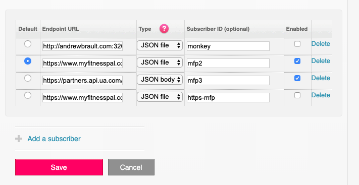

Hi @JohnFitbit it looks like we were turned off again at around 2019-08-09 14:48:54 (38 minutes ago). The odd thing is when this happens, you'll see in the 2nd screenshot that we're still enabled. In order for us to turn it back on, usually we need to disable it, and then re-enable it. This time that is not fixing the issue.

We are seeing the same thing.
Normally I receive 5 to 20 notifications every second or two -- for the last 20 minutes, haven't received anything.
Looking at Fitbit's delivery log, we've been 100% successful receiving notifications for the entire log. I've tried disabling/re-enabling and still nothing is coming in and they're showing no attempt to deliver notifications ... it's like Fitbit's notification system is down.
