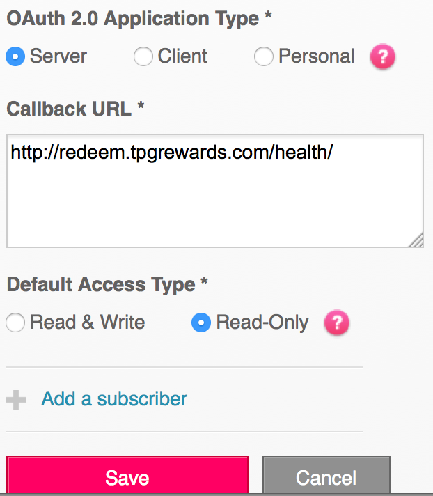

hi there community...
i have a nagging problem when using the OAuth2 for authorization and then requesting the access tokens and stuff. i do get state and code back after the authorization. when doing the next step - getting the long access code - using this as an example from https://dev.fitbit.com/docs/oauth2/#access-token-request
POST https://api.fitbit.com/oauth2/token Authorization: Basic Y2xpZW50X2lkOmNsaWVudCBzZWNyZXQ= Content-Type: application/x-www-form-urlencoded client_id=22942C&grant_type=authorization_code&redirect_uri=http%3A%2F%2Fexample.com%2Fcallback&code=123456789
instead of the example reply there i get this:
"errorType":"invalid_request","message":"Redirect_uri mismatch: http%3A%2F%2Fredeem.tpgrewards.com%2Fhealth%2F. Visit https://dev.fitbit.com/docs/oauth2 for more information on the Fitbit Web API authorization process."}],"success":false}"
how is this possible since i just used the same callback url to get the authorization and now just trying to get the access tocken so i can test some requests? the url in the token call matches the app setup for the client id which is the same as the one used when doing the oauth2 athorization.
what am i doing wrong?
thanks...

i saw the flow you are describing and in my implementation there is nothing different. also if you work for fitbit you can see that my calls are referring to the url entered in the "Callback URL" field for the app settings and they both match (see image at the bottom)...
here... my code for authorization i have:
$my_client_id_from_fitbit = '229YKV';
$my_client_secret_from_fitbit = 'verysecretstringhere';
$my_callback_url = 'http://redeem.tpgrewards.com/health/';
and at the time requesting the access token:
$token = base64_encode(sprintf('%s:%s', $my_client_id_from_fitbit, $my_client_secret_from_fitbit));
$http_headers = array ("Authorization: Basic ".$token, "Content-Type: application/x-www-form-urlencoded");
$call_url = 'https://api.fitbit.com/oauth2/token';
$code = 'code_i_just_got_from_authoriaztion_call';
$data = [
'client_id' => $my_client_id_from_fitbit,
'grant_type' => 'authorization_code',
'redirect_uri' => urlencode($my_callback_url),
'code' => $code
$data = http_build_query($data);
etc...
as you can see all 3 different occasions point to the same url. and the authorization works. so... you might understand that from where i am sitting the error for mismatched_url looks (and feels) - in the best case scenario - suspicious....
so, basically, my next step is to create a fresh new app and start form scratch... i'll recreate every steep so far and will report back.
thanks again for your reply...
