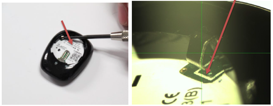

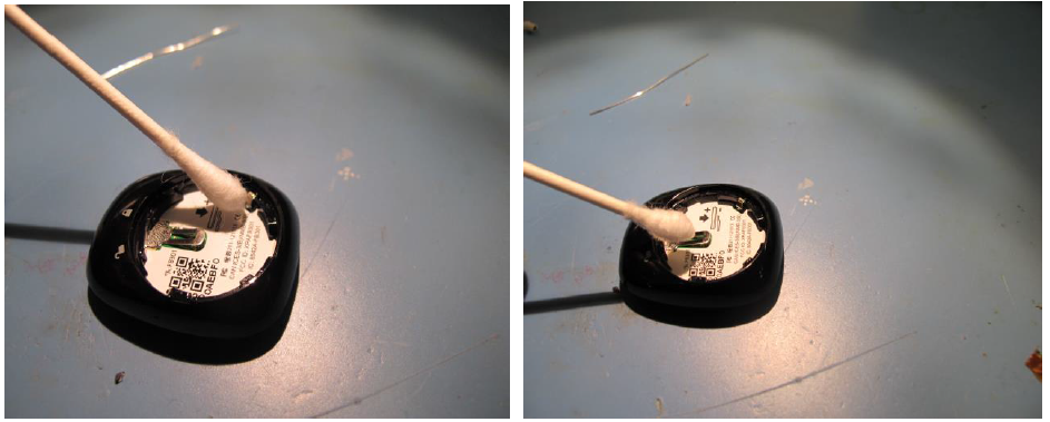

@SunniS Welcome to our Community! It could be that the battery is loose within the tracker and this may cause incorrect battery readings. Please take out the battery and clean the contacts with a cotton swab and rubbing alcohol. After this make sure the contacts are aligned and not depressed that could make the battery loose within the tracker. Check the following pictures for a visual guide:
Let me know how it goes!
