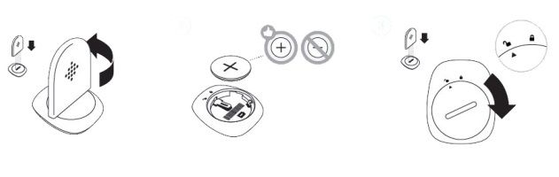

When your Zip shows a low battery sign, it means that the battery needs to be replaced, a fresh 3V coin battery, CR2025 will need to be put in; open the Zip with the door tool and replace the old battery, like this:
Putting zip's battery
