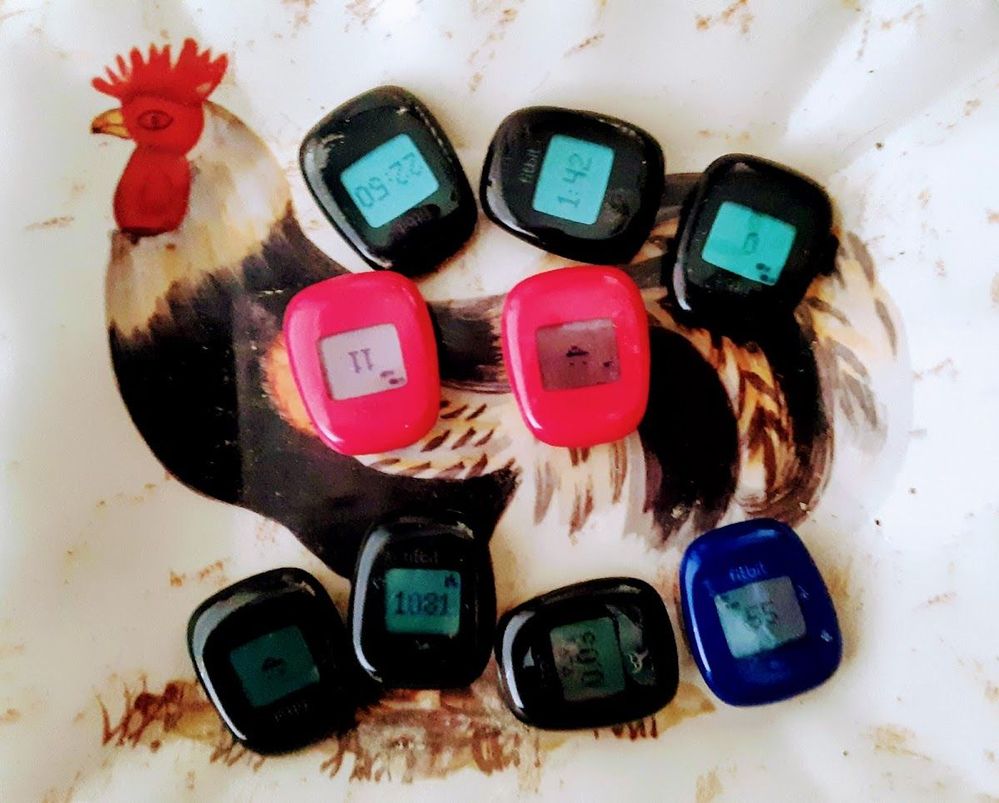

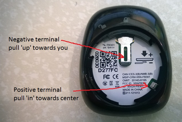

@AnitaCS @EGomar no, Fitbit hasn't disabled the ability to update the firmware. Some ZIPS won't update, unfortunately, it's a known issue, and the same thing happens with some Fitbit Ones at firmware version 6.46. One workaround I've used successfully in both scenarios is updating from a different older device with an older application, specifically my Windows10PC or my Amazon Fire tablet vs. my Androids. I've even got an old HP touchpad with Android with the old version that comes in handy for these situations. May I recommend if buying something from eBay, presumably with 30-day or 60-day free returns to open the box and set them up within your return window? Even if you want it for a backup for the future, open boxes, connect, sync, and update, then go back to your old tracker. Otherwise, you may be buying someone else's problems.
Cockadoodlezip
Here are several ZIPS that supposedly didn't work or update, yet all are working perfectly now after updating with my older apps and adjusting the contacts to better connect the battery.
Good luck and happy stepping!
