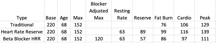

The Versa family of devices, as well as the Ionic, have assumed the new Heart Rate Zone formula formerly only used by the Charge 4 - the "Heart Rate Reserve" method instead of the "Traditional" formula.
In the chart below are two data rows showing Heart Rate Zone cutoffs:
The first data row represents the Traditional formula which are straight fixed percentages (50, 70 and 85%) of your Max Heart Rate which is defined as subtracting your age from 220. For me, as a 68 year old male, my Max Heart Rate is 152.
The second data row represents the Heart Rate Reserve formula. Subtracting your resting heart rate from your traditional max heart rate results in that reserve.
     40% of the reserve is added to your resting heart rate to establish the beginning of the Fat Burn Zone.
     60% of the reserve is added to your resting heart rate to establish the beginning of the Cardio Zone.
     85% of the reserve is added to your resting heart rate to establish the beginning of the Peak Zone.
The HRR zones are commonly referred to as "Training Zones". We won't talk about what my Cardiologist calls them.

Ahh - had I known about the health issue, I would have added in changing your Max HR as I have done. I reduced by Max HR by 20% because I take Beta Blockers which throttle the heart rate down even when exercising.
Good to hear you figured it out.
